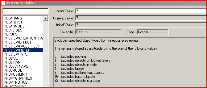

Dadgad Posted April 18, 2012 Posted April 18, 2012 (edited) How do you know it is not an image, without knowing what it is? An image doesn't necessarily mean a photograph or drawing, an image can be text based too. I am thinking that CyberAngel may be on the right track here. Try setting your FRAMESELECTION variable to '1' at the commandline. If that doesn't do it, then try setting your PREVIEWFILTER variable to '0' at the commandline. Edited April 18, 2012 by Dadgad Quote

Ty520 Posted April 18, 2012 Author Posted April 18, 2012 PREVIEWFILTER and FRAMESELECTION do not appear to be valid in AutoCAD 2005 Quote
