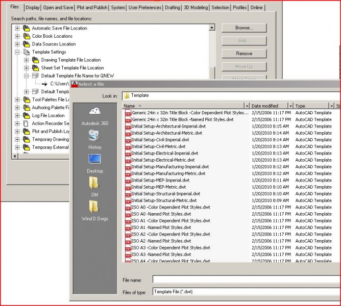

Welcome to the forum. Don't you have a DISPLAY at Startup option in the lower left corner of the SPLASH screen?
Set your default QNEW template as shown in the image.
If you want some more options for startup, look at the SYSTEM VARIABLES option values.
