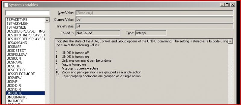

U might want to check your UNDO system variable setting too :wink:.

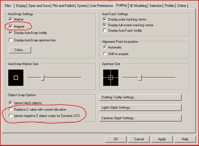

Check your osnap settings as well this will cause jumping to wrong point you can override though hold shift down then press left button on mouse temporary snaps come up. In a lisp you can continuously change the snap as required.

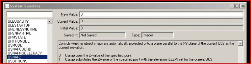

Some more grist for your snap jump mill. If you are working in 2D, consider the Z axis options shown.

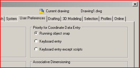

You can also prioritize data entry to your preferred setting.
