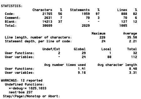

Does anyone know of a utility which will count the lines of code in a LISP program? One which would ignore comments and only count actual lines of code.

How about something as simple as:
(defun c:CountLISPLines ( / file line lines )
   (if
       (and
           (setq file (getfiled "" "" "lsp" 16))
           (setq file (open file "r"))
           (setq lines 0)
           (while (setq line (read-line file))
               (if (not (or (eq "" (setq line (vl-string-trim "\t " line))) (wcmatch line ";*")))
                   (setq lines (1+ lines))
           (close file)
           (princ (strcat "\nFile contains " (itoa lines) " lines of code."))
Bill re 1000 lines of code a question each time you start a new program do you repeat the same lines of code over and over ? would 20 lines of code be better as a single line calling a autoloaded library lisp, If you answered yes then it is probabbly time to look at a library, i was involved in a commercial product and the first few lines of code were the same in every program and layer manipulation was always calls to a library function because we had a smart layer manager, no use input or hard coding. Somewhere around 150+ lisps rather than 1 big one. As you say load time has never been a problem.
Thanks Lee and BigAl,
I ran the code and it came up with 2,330 lines on the latest program. Now of course each of us programs in different styles. I always try to keep only one command on each line and only commands like TRIM do I start to spread things out so I can see what I'm doing and debug later. And most of the time I place the last parenthesis for PROGN and IF statements on their own line. I actually allowed the IDE to format my code and wow did it ever spread things out. Looked good but it also became too hard IMHO to debug because it really spread the text over many lines.
