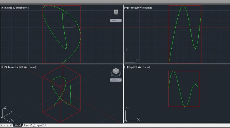

Hi Marko
I have thinking to another way to find the limits (bounding box) of a spline. The idea is to find the limits of some projections of spline on x, y and z axis.
This is a VERY limited tested version, but I think it might be useful.

Stefan, why do you think it's very limited tested version... I think it's even better than first your code - it doesn't iterate 500 times while running... I've already implemented into my BBox.lsp and see no lack... Thanks, Stefan, you are really genius... And first code was real master piece and now this second, without (vlax-curve-getfirstderiv)...
All the best, M.R.
