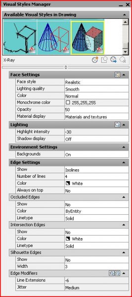

In later versions there is a very nice visual style called XRAY which is a really nice way to see through obstructions, and gives a pretty good overall view. I can't see any reason why you couldn't set this up in 2009.
