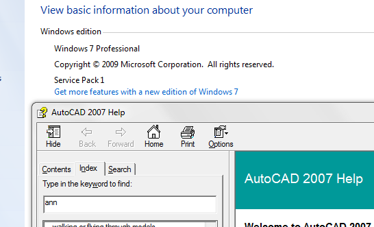

ReMark Posted June 11, 2012 Posted June 11, 2012 As you can see by the above I have 2007 installed directly in Windows 7 Pro SP1 here at work. Quote
raye215 Posted June 11, 2012 Posted June 11, 2012 Ok Thanks ReMark. I will make a restore point (just in case) and then install 2007 in Win7. Quote
