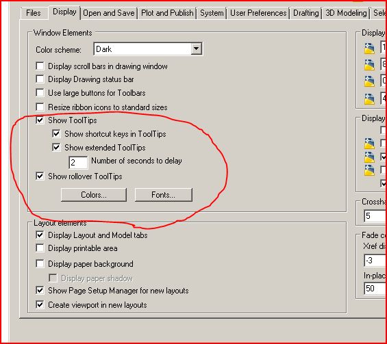

If your tooltips are not turned on , they probably should be, as shown in the image. Good luck, the sky is the limit, and in modelspace there is none, so relax and have a little fun. :)
