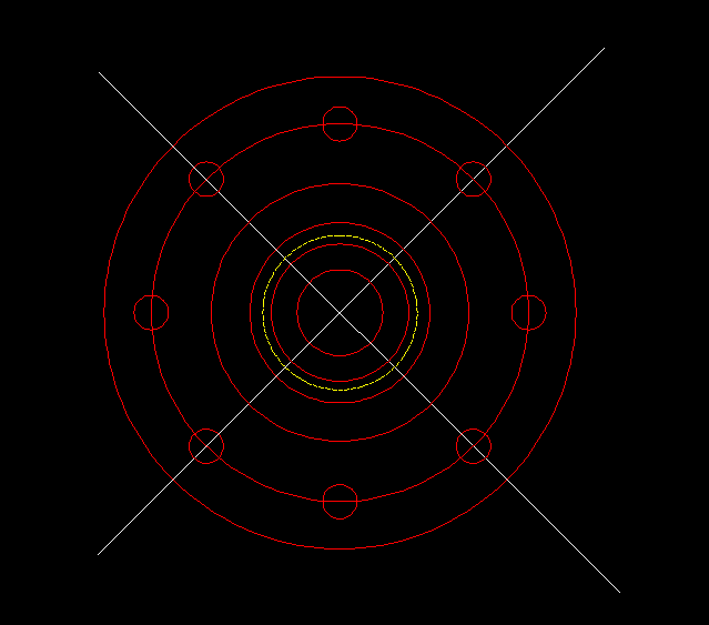

I am a total noob to AutoCad. I am taking my first semester and my instructor is not very good. I have a circle that I have arrayed 3 smaller circles on. On 4 of the circles I need to rotate the centerlines about 45 degrees. Is there a way to rotate these?
ALTENES_TB_52C.dwg
Your drawing has seven small circles with centers (white) passing vertically and horizontally through four of them. You can rotate the centerlines with the ROTATE command and when prompted to specify the basepoint of the rotation pick the intersection of the two centerlines. When prompted for the angle type then press Enter.
Thank you for your help. I got it to work just as you said.
