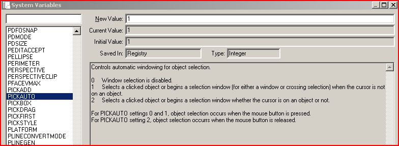

I'm not really sure if there were more than 2 PICKAUTO variable options in 2007, but maybe.
These options are available in 2012.
Edited by Dadgad
2007 has the same six "PICK*" system variable as you show above.
