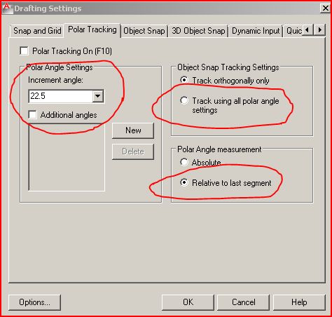

I want to be able to see angles in Dynamic Input with the base line set where I need it to be.
In the red is where AC puts the baseline in the DYN command.
Is there a way for me to "tilt" the baseline so i can use it in ANY angle, like in the blue?
* I am referring to the baseline as where 0 degrees begins*
adjusting baseline in DYN.dwg
You should consider the different available polar tracking options in your settings.
Excellent! I did not know about this. That works out just fine and just in time for a big ol' project tonight.
Thanks a heap ol' buddy!
