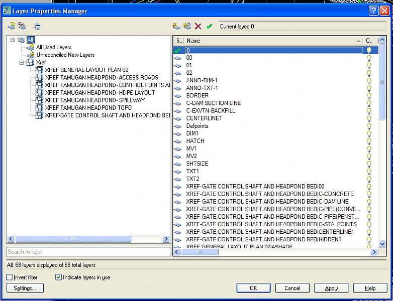

does anyone know if you can turn off layers on an x-ref which has been inserted into a drawing. instead of having to go back to the original x-ref to switch layers on and off and then have to re-open the drawing to make changes. a way of editing the x-ref whilst it has been inserted into a drawing

I thought the xref layers were displayed within the layer manager of the destination drawing - at least they are here unless I have missed your point.
is visretain the variable you were looking for?
or you could toggle the layers of the xref on the current file using the xref on your layer properties manager.
Yep, like Nocturne said, by setting VISRETAIN to 1 the changes you make to x-reffed layers are svaed in the current drawing.
