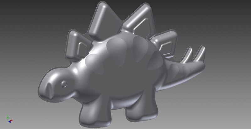

I have attached a picture below (Dino_01.jpg) illustrating what I am trying to do. I am trying to extrude some "stripes" on the curved back of this dino food container I am playing around with.
In the past, I have attempted to use a method of extrusion (subtraction) + boundary patch + sculpt + thicken / offset, but the results where not satisfactory or uniform. This issue is probably my experience with this software. I have attached a photo of those results below as well (Dino_02.jpg).

You can't extrude a non-planar form.
What's wrong with the shapes that you've created there? If you blend the edges in to the rest of the form, it doesn't look like it would be inconsisten with the rest of your design.
Use those projected 3D sketches to Split the face of the solid.
You can then do a Thicken with Cut option and then add fillets.

Thanks for the response JD Mather and everybody else!
The split tool solved the issue!
