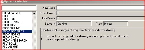

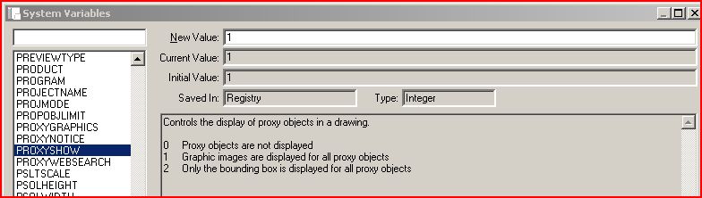

Here are a few things to consider, regarding your system variable settings mostly.
You also might want to open your HIDDEN MESSAGES settings on the SYSTEM tab of your OPTIONS and see if there is any help there, in terms of displaying warnings from the software.
You may wish to reverse a previous instruction for a default response to an AEC Object issue, or something like that, which would have been moved to your HIDDEN MESSAGES dialog box.
