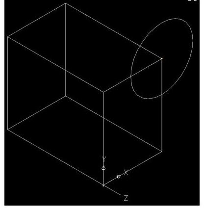

dreamer Posted May 6, 2012 Posted May 6, 2012 I want to pick the point where the circle hits the edge of the box but there seems to be no Intersection there. But they are on the same plane! Quote
Dadgad Posted May 6, 2012 Posted May 6, 2012 You might want to try using APPARENT INTERSECTION. Quote
dreamer Posted May 6, 2012 Author Posted May 6, 2012 Tried but no snap. Also strange that I tried entering the coordinates using Polyline: snap at the centre of the circle, @-500,0,0 ,nothing happen but this work with using Line. Quote
ReMark Posted May 6, 2012 Posted May 6, 2012 I suspect your geometry is off. Post a copy of the drawing file here so we can take a look at it. Quote
dreamer Posted May 6, 2012 Author Posted May 6, 2012 What does it means "geometry is off"? Oject Snap at Intersection.dwg Quote
dreamer Posted May 6, 2012 Author Posted May 6, 2012 How can anything be wrong? Its just a simple box and a circle Quote
Dadgad Posted May 6, 2012 Posted May 6, 2012 The reason you cannot snap to it is because the lines are really a 3D Solid. It is not the same as snapping to a point on a line. In 2011 or 2012 3D Object Snap was added to the program. Sorry to barge into the middle of your clarification and cut to the chase, ReMark, saw your new posts after posting this. Quote
JD Mather Posted May 6, 2012 Posted May 6, 2012 Wouldn't quadrant snap (assuming center is on the vertex corner) be the same result? Quote
Dadgad Posted May 6, 2012 Posted May 6, 2012 As fate would have it, in this particular instance that would do it JD, but might not get so lucky the next time. Let's not all rush into the shed looking for some dynamite ... exploding solid things is just so heavy handed. If you really need to do it, to find that point on a random 3D Solid you could just trace the edge, providing an intersection snappable reference point. Quote
dreamer Posted May 6, 2012 Author Posted May 6, 2012 Snap to quadrant will work but my point is to find out why intersection doesn't snap even if the circle is changed to a line on the box face. Now I know it's because the line is not a line as Dadgad explained. Also strange that I tried to get the "intersection" point by entering the coordinates using Polyline: snap at the centre of the circle, @-500,0,0 ,nothing happen but this work with using Line So why is Pline doesn't work in this case? Quote
Dadgad Posted May 6, 2012 Posted May 6, 2012 PLINE won't work because of the UCS in which you are trying to use it. It will only work on the XY plane of your UCS. Use a 3D polyline, then you will not have any problem, no matter what axis you want to create it on. Quote
JD Mather Posted May 6, 2012 Posted May 6, 2012 You might experiment with xedges (change current color first, probably should make a new active layer). Quote
dreamer Posted May 6, 2012 Author Posted May 6, 2012 Thank you Dadgad. But I am working on the XY plane. Anyway 3D polyline did the trick, I complete forgot about this tool. Thanks. Quote
