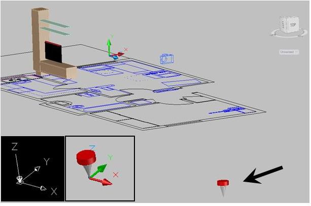

Hi, can someone please tell me what that big red-head-pin doing on my drawing?
When UCS is at World, it stick at the Z axis (see insert picture at the bottom left corner).
Thanks.
Did you enter GOOGLE EARTH coordinates for it?
No. But perhaps I did, I set the my location using Location Picker at the Map provided.
:) Thanks. So it is not an indication that something is wrong. Possible to turn it off?
No, you're not doing anything wrong.
:)Possible to turn it off?
GEOMARKERVISIBILITY = 0 at the command line.
Thanks nestly. Not that I really want it off but it's nice to know. :D
