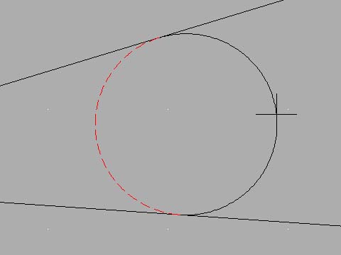

I would say that the easiest way would be to draw a circle using the 3P option. The three points would be Node (to the point) and Tangent to each of the two lines, as in my picture.
I am not too sure about your last statement, because if the circle is drawn as tangential to the line, then the circle can be trimmed out from the tangential lines :D

I tried it with the 3P circle and for some strange reason, now and then it's not possible to trim the circle afterwards. (it's probably me but it's still strange :D)
Having used AutoCAD for a year or three, it comes quite naturally to me to think in terms of trimming a circle to make an arc in a particular situation. It seems that the arc command in AutoCAD has its shortcomings.
As far as trimming goes, if the trim does not work, I stand for no nonsense, draw a line Perp from one tangent, to the centre of the circle and Perp to the other tangent. Trim, by picking these two new lines as the cutting edges, and then picking the bits to be removed. Then finally erase, P, and the two lines vanish without having to pick them again.
