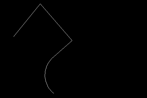

nestly Posted May 7, 2012 Posted May 7, 2012 I would recommend you forget about both JOIN and PEDIT>Join, and add LeeMac's PolylineJoin Lisp to your startup. It doesn't care if they're lines, polylines, or arcs ...... everything selected will become a polyline, and every entity that shares and endpoint will be joined together into a single polyline. http://www.lee-mac.com/polylineprograms.html Quote
Dadgad Posted May 8, 2012 Posted May 8, 2012 While I use ACTIONRECORDER a lot, and like it, this lisp of Lee's looks like just the ticket. Why aren't I more surprised? Lee Mac, say no more. ....except of course, thanks Lee! Quote
Blackfish Posted May 11, 2012 Posted May 11, 2012 (edited) A short macro for LT users: ^C^C_select;\_pedit;l;y;j;p;;; It's not as good as LeeMac's lisp, but it works as you see on the animated gif two posts above PS. Apologies SLW210 Edited May 14, 2012 by Blackfish wrong coding Quote

Blackfish Posted May 14, 2012 Posted May 14, 2012 A slightly better macro. The earlier one has a problem when you select existing polyline $M=$(if,$(eq,$(getvar,peditaccept),1),^C^C_select;\_pedit;all;j;p;;,^C^C_peditaccept;1;^C^C_select;\_pedit;all;j;p;;;^C^C_peditaccept;0) PEDITACCEPT - system variable affects PEDIT command; 0 - when you select a line AutoCAD asks you "Object selected is not a polyline Do you want to turn it into one?", 1 - no question. Quote
