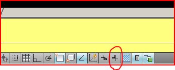

You can choose to show or hide lineweight by clicking the icon shown inside the red circle, at the bottom of your display.
You hopefully have already turned on PLOT PREVIEW in your QUICK ACCESS TOOLBAR, at the top of your screen in the left corner.
The PLOT PREVIEW is a very convenient way to very quickly answer the question of will it look good?

You hopefully have already turned on PLOT PREVIEW in your QUICK ACCESS TOOLBAR, at the top of your screen in the left corner.The PLOT PREVIEW is a very convenient way to very quickly answer the question of will it look good?
This is a great screenshot! Thank you. Thread solved and can be closed.
