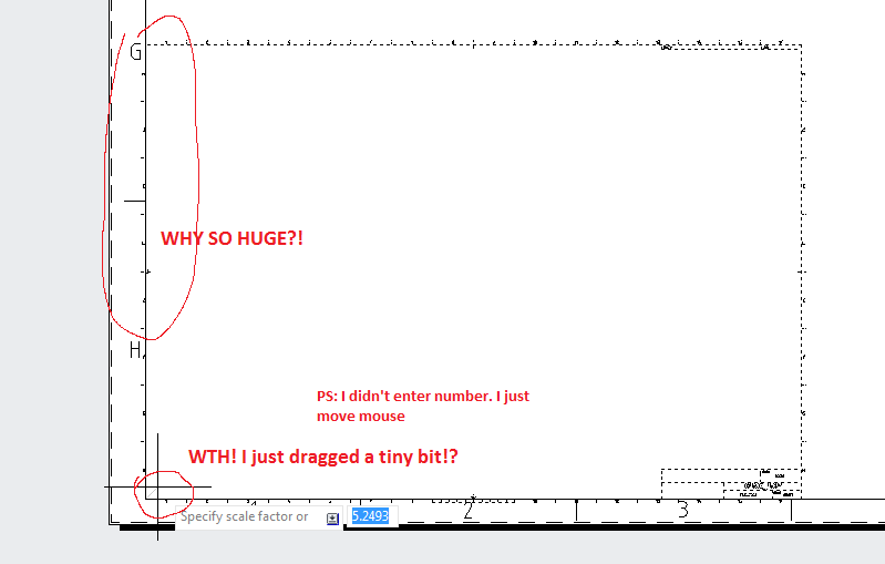

D1-Xen Posted May 12, 2012 Posted May 12, 2012 When I use the "SCALE", sometimes it scales according to the size I want as in, I can drag it and control the size I want. But sometimes when I select a whole bunch of stuff, the objects just blows up even when I moved 0.5 cm of my mouse... Any ideas why? Quote
Dadgad Posted May 12, 2012 Posted May 12, 2012 If you hope to scale accurately, you should get used to using an exact SCALE FACTOR. Might it have to do with how far you are zoomed into or out of your drawing? Quote
D1-Xen Posted May 12, 2012 Author Posted May 12, 2012 If you hope to scale accurately, you should get used to using an exact SCALE FACTOR.Might it have to do with how far you are zoomed into or out of your drawing? Yes, I know how to scale accurately, but that is my main question. For example, I have a drawing which takes up approximately 1/4 of an A4 page, I want to scale it so it fills the whole page. Yes, I can make it in the a multiply SCALE FACTOR of 4. A better example will be I have a "Title Block" which I copied from an A1 ISO paper format. Scaling it down by the factor does makes the inner area drawing too small. So I want it a drag method. If you use PS CS5, I wish it could have something like the "Transform" function. But do you get what I mean? I want the scaling to my liking, not by scale. How do I do it? Of course, without blowing crazy... Quote

nestly Posted May 12, 2012 Posted May 12, 2012 WHT! I just dragged a tiny bit!? Define "tiny bit" If you're zoomed in very close, moving your mouse a "tiny bit" may be only a fraction of a unit, whereas if you're zoomed way out, moving you're mouse the same distance on the screen may be hundreds or thousands of units. I can see from dynamic input in your screencap the "tiny bit" you moved your mouse is 5.2493 units, ie a scale factor of 5.2493. The bottom line is that you CAN NOT scale accurately by dragging the mouse (eyeballing), you can only scale accurately by entering a scale factor or using OSNAPS/Reference lengths. Quote

dbroada Posted May 17, 2012 Posted May 17, 2012 another vote for "I never do it that way". Either enter a scale factor or use the R(eference) option within SCALE. Quote
eldon Posted May 17, 2012 Posted May 17, 2012 If you try and use the Reference option to Scale, you will find that you have much more control in dragging to the size you wish (to echo the advice in the previous post). Quote
