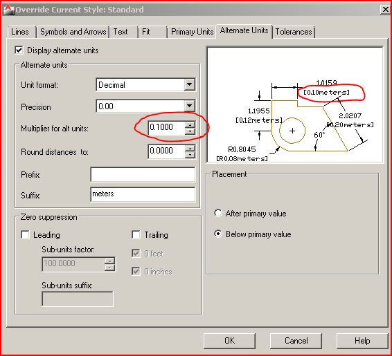

l00k_uk Posted May 13, 2012 Author Posted May 13, 2012 so out of curiosity is there a way of viewing dimensions in meters instead of decimetres? Quote
Dadgad Posted May 13, 2012 Posted May 13, 2012 Yes, you can do that by turning on the ALTERNATE UNITS dimension display and applying the multiplier which would be 0.1 to convert decimeters to meters. I have placed it below the dimension line in the image. Hope that helps you out, now go back to work! Quote

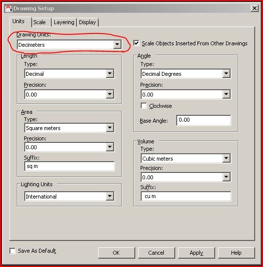

Dadgad Posted May 15, 2012 Posted May 15, 2012 Hey check this out, it is the first time I have ever seen the dreaded DECIMETERS referenced anywhere in Autocad! I ran the AECDWGSETUP command on the architectural desktop, and lo and behold........ Quote
