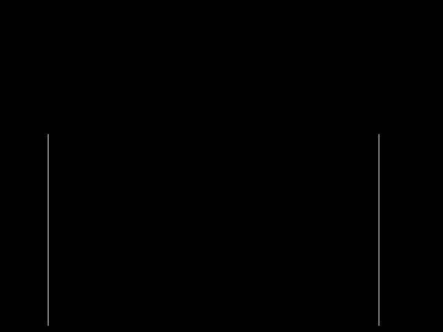

Hi, how can i find the middle point in this case? Thanks, and sorry for the dumb question. :(
You can use the M2P command modifier; will be asked to indicate two points and AutoCAD will calculate the middle location between them.
Hmm, nice!
What can i do if i want to do a 30º line from this corner (like in the picture) to the midpoint?
M2P is not a command by itself, as Mircea stated it is a command modifier, meaning that it is used while in the middle of another command.
For instance if you were drawing a line, and had started the LINE command, when asked for the location of either the starting or end point
you could enter M2P , you would then be asked to select the two defining points, after which the midpoint between them would be used as the point entry.
Activate the Ortho mode (F8) and draw a vertical line from that middle to above. Next draw another line at the desired angle - use polar relative coordinates:
@100<30
Last step use TRIM or EXTEND to fix the sloped line; erase the helper entity (said vertical line).
Hmm, nice!
Use the COPY command and M2P to define the location to which you want to copy it.
Oh! Now i understood the command, thanks dadgad.
So that can't be used for what i wanted, yeah? I think it's easier drawing a line in the middle and then erase it.
@Edit: Thanks! Now it's everything Ok! :*

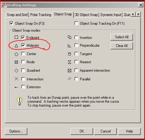

What I would do is just turn on my MIDPOINT snap, then it gets real easy. :)
