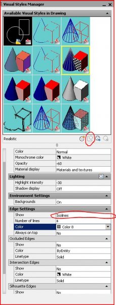

Hi is there a way to get rid of lines in realistic 3d view. I want it to look smooothe.
What lines are you referring to? There shouldn't be any lines showing.
Can you post an image?
You should open your VISUAL STYLE MANAGER and take a look through the various settings options there.
If you change EDGE SETTINGS from ISOLINES to NONE, the edge lines will disappear.
If you want to apply the visual style changes to the current drawing then you click inside the upper red circle.
Lots of things to adjust here, if you have a mind to.
