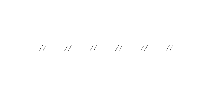

I'm trying to make a linetype for plugmold which is like this
_____ // _____ // _____ // _____ // _____
And this is the code I've entered
*PLUGMOLD,DASH 2SLANT DASH _____ // _____ // _____ // _____ // _____.
A,0.5,-.5,[sLANT1,]typshp.shx,x=-.2,s=.2],-.5,[sLANT1,]typshp.shx,x=-.2,s=.2],-.5
Please advice on whats wrong cos I'm not able to load it!
Thanks

Did this using Express Tool commands Make Shape and Make Linetype.
The linetype definition file looks like this:
*PLUGMOLD2, short line followed by two slanted lines
A,.426613,[sLANT1,C:\Users\ReMark\Desktop\SLANT1,s=1],.073387,-.376613
How did you come up with the inputs on the second line?
Edited by ReMark
Maybe something very simple using text:
*PLUGMOLD3,Plugmold 3 ___//___//___//___//___// ___
A,.75,-.25,["//",STANDARD,S=.2,R=0.0,X=-0.15,Y=0.0],-.2

Maybe is just some typo..
A,0.5,-.5,[sLANT1,ltypshp.shx,x=-.2,s=.2],-.5,[sLANT1,ltypshp.shx,x=-.2,s=.2],-.5
I don't think it is the typo shown above that is causing the problem. As a matter of fact I'm pretty darn sure it isn't.
AutoCAD Help
The following syntax defines a shape as part of a complex linetype.
[shapename,shapefilename,scale,rotate,xoffset,yoffset]
Now look at this: [sLANT1,]typshp.shx,x=-.2,s=.2]
Shape definition is [sLANT1,] which is not going to work.
The rest of syntax typshp.shx,x=-.2,s=.2] has no meaning.
So, if the file name is ]typshp.shx it must be renamed.
Maybe will not solve all the problems, but that bracket is definitely in the wrong place.
The shape SLANT1 is not standard in my version of ltypeshp.shx, so perhaps the shape definition of SLANT1 should be looked at. :unsure:
If the OP's ltypeshp.shx has been customised, then that file would have to be sent with the drawing file for the line type to be formed properly on another computer.
I think the solution as put forth by Blackfish would be the easiest / quickest followed by mine suggesting the use of the Make Linetype command from Express Tools.
The only risk with my solution is, if someone has a something strange set as a 'STANDARD' text style, but who does it?
You would be surprised at what some users do.
