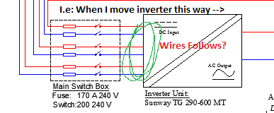

D1-Xen Posted May 17, 2012 Posted May 17, 2012 The headline is very self explanatory... I was wondering, since I am drawing a lot of circuit stuffs, whenever I am moving an inverter or module shape around, I always have to either shift those wires or extend them to some extent. I was wondering, like Google SketchUp, can AutoCAD have a follow extension mechanism for a fix point with an fix object? I would love so that only one wires extends. So I am just looking at a linear expansion for now. I am not looking for complex 3D expansion... I just want 90° lines to extend: Quote
BIGAL Posted May 17, 2012 Posted May 17, 2012 Try STRETCH use window right to left will work exactly for a inverter unit as shown above. Quote

dbroada Posted May 17, 2012 Posted May 17, 2012 I use STRETCH but am also looking at geometric constraints (both mentioned elsewhere). The other alternative if you do a LOT of circuits is to look into using AutoCAD Electrical. It has a steep learning curve and promises much which is too difficult to obtain but you can just pick up your device and watch the wires repaor themselves, then drop it elsewhere and all the connections are remade. Quote

D1-Xen Posted May 19, 2012 Author Posted May 19, 2012 Genius command! Command: STRETCH it is! Thanks BIGAL. Case closed. I just tried the STRETCH command again. But sometimes it works, sometimes it just moves my selected objects along the line... What did I do wrong? Select Ojects > STRETCH > Left Click > Specific base point > ??? I get movement object instead. I got it right the first time, but I cannot get it right again. Help? This is in reference to re-try stretching those wire for my picture above (inverter + wires). Along BIGAL's suggestion, please check also the solutions from this previous discussion. No problem drawing rectangles and stretching them. I got the lines to follow. Great tutorial. But when it comes to wires, it does not work. Quote
dbroada Posted May 19, 2012 Posted May 19, 2012 you must select from right to left to get a crossing selection. If you select from left to right you only stretch the things contained entirely within the window. Is that how you are doing it? Quote
D1-Xen Posted May 19, 2012 Author Posted May 19, 2012 you must select from right to left to get a crossing selection. If you select from left to right you only stretch the things contained entirely within the window. Is that how you are doing it? Yeah, it seems to be the problem. I noticed that it won't stretch if I just move the inverter to the far right first then stretch the wires. I got the select the inverter + the wires to make it work. Thanks for pointing that out. Quote
