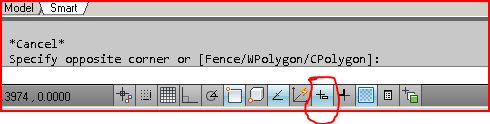

Update: In addition, I also noticed that I do not get a textbox next to my cursor while typing commands. I love to have this back. How do I get it back? This affects me a lot as I can no longer see my scale factor and alike...

To get the text box back near your cursor you need to turn on your DYNAMIC INPUT as shown in the image.

Great! Problem solved! Thank you Dadgad!
