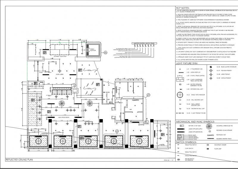

Trovato14 Posted February 6, 2013 Posted February 6, 2013 Hi Eldon- I found a solution for the bold text: Downloaded and installed CUTEPDF, a third party printer. This corrected my unusual and randomly bold text issue. But now I have a new issue, there is a random and mysterious line that shows up diagonally across my entire page, only shown after plotting to PDF. I am attaching a screen shot because my PDF file is too large to upload, 1.5MB. See attached and let me know what you think. Thank you SO MUCH for the quick response. Quote
eldon Posted February 6, 2013 Posted February 6, 2013 I have never had such a line in my work. I could not begin to guess what it is Quote
Renslo Posted February 8, 2013 Posted February 8, 2013 Hey Eldon, when your plotting click on "scale lineweights" under 'plot scale' and see if thats the problem Quote
