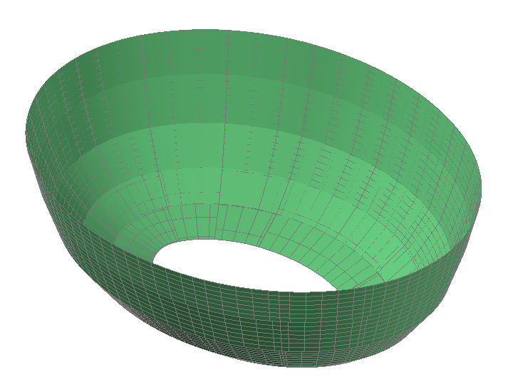

My feeble attempt. Unfortunately I can't put any more time into it because I'm off to dinner with friends shortly. Maybe tomorrow (Saturday) if I have some free time. This is done as a surface not a solid.
Ellipse
Trim
Revolve
Slice (twice if you want bottom flat similar to ReMarks feeble attempt). Actually now that I think about it you could do it with on slice using [ shaped surface.
solidedit shell

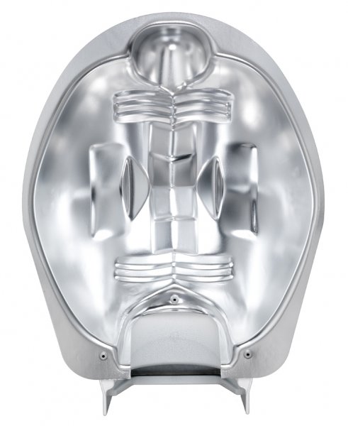

There you go. That's the best I could do. I attached a couple of pictures of the item I'm trying to model. Just the general shape
is needed though.
That file looks like an Extrude rather than the Revolve I suggested.
I think your definition of "general shape" might be needed now that you supply a picture.

I used an arc and the SWEEP command. My path was one quarter of an ellipse.

Seeing your picture I would do a Loft rather than Revolve or Sweep.
Add a bit of the outside detail and then Shell it all.
