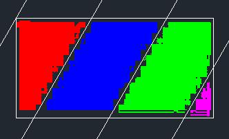

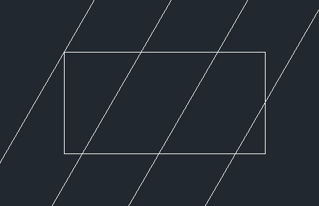

Hi everyone,
New to the forums so let me first say thanks in advance. I'm not a programmer but I dabble so I'm looking for any and all help I can get.
I currently have a job where I'd like to reduce the time involved on some of our drawings but not sure if what I want to do is even possible.
Right now, using the bpoly or boundary command the user has to select an internal point to create a closed poly. What I'd like is to eliminate the user interaction. So would it be possible to create a lisp routine that could create a set of closed polys from a selection set similar to the objects in my attached image? In that image the user what have to click four times to create the needed four closed polys. It would be nice if a routine could select all the entities on the set layers and create them without any user interaction.
More details: The image is a simple example. The lines would always be construction lines but the angle could be anything. They would always offset equal distances (simple array in this case). The rectangle could be any shaped closed polygon, possibly even a circle, though we haven't run into that yet.
Hopefully that was somewhat understandable. Anything that might help point in the right direction would be great.

Here is a dirty method (create duplicate boundaries)
Try it on your drawing

Now what we need is a sample drawing. better post one, that way we would not be guiessing what works and what doesnt.
FIXOs code will work if the "contours" are Xlines. I guess with a little tweak on the code you can make it work for Lwpolylines/Lines.

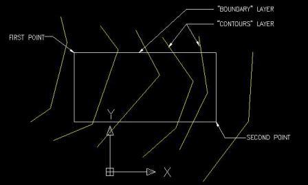

Anyhoo.. try this code
(defun c:bpp (/ _mid p1 p2 ss ref pts)(vl-load-com)
(defun _mid  (p1 p2)
     (mapcar (function
                   (lambda (a b)
                         (/ (+ a b) 2.)))
             p1 p2))
(setq om (getvar 'osmode))
(if (and (setq p1 (getpoint "\nPick First point: "))
        (progn (initget 32)
               (setq p2 (getpoint p1 "\nPick Next point: ")))
        (setvar 'osmode 0)
        (setq ss   (ssget "_CP"
                          (list p1  p2
                                (polar (_mid p1 p2)
                                       (+ (/ pi 2.0) (angle p1 p2))
                                       0.1))
                          '((0 . "LWPOLYLINE") (8 . "contours")))))
      (command "_Line" "_non" p1 "_non" p2 "")
       (setq ref (vlax-ename->vla-object (entlast)))
       (repeat (sslength ss)
          (setq pts (cons (vlax-invoke  ref 'IntersectWith
                        (vlax-ename->vla-object(ssname ss 0))  acExtendNone) pts))
             (ssdel (ssname ss 0) ss))
       (vla-delete ref)
      (setq pts  (append (cons p1 (vl-sort pts (function (lambda (x y)
                                    (< (distance p1 x)(distance p1 y)))))) (list p2)))
      (mapcar (function (lambda (j k)
                (vl-cmdf "_.-boundary" "_A" "_I" "_N" "" "_O" "_P" "" "_non"
                      (_mid j k) "")))
                                pts (cdr pts))
   (setvar 'osmode om)
Pick two points that will intersect the contour lines within the boundary

I see, the way the code is written now, the entities intesrsecting the box should a Lwpolyline and resides on "contours" layer. Anyhoo. I will write another one to follow Blackfishs' suggestion. As for "entites can be any layer.." I believe what Blackfish said sums it up for you.

This time the code is not limited to entity type and layers except the "shape" should be a LWPOLYLINE
The direction of the contours preferably is the same-ish for all. (left-to-right/ right-to-left) NOT [uh-uhhh/can't happen/not gonna do it] going to work for "FAN" shape. you'll know it when you see it.
Edited by pBe
_Hilow Sub modified
pBe: Still no luck with your lisp routine. Attached is a very simple drawing to see if that helps. I used construction lines but they could be any type of line and trimmed if needed.
Thanks again.
Example.dwg
Cant test your drawing, stick stuck in 2009. besides TrueView cant covnert it either. try saveas 2007
