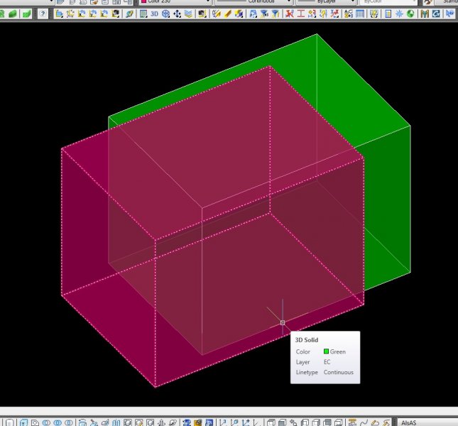

In the picture below, the red box is in the foreground and the green in the background, my cursor is over one edge of the green box and the quick properties even relates to the green box, however the rollover highlight has the red box and that's the one I'll get if I try to select.

2 excellent suggestions above, I don't use shortcuts in the drawing area but I did turn it on to try the Right-Click>Subobject Selection Filter>Edge - but of coarse that gives me the edge and I wanted to select the whole object. The SELECTION CYCLING works but doesn't give you grips when you select a different object from the selection list, so no good for me.
Not sure what use the X-Ray view style is for if I keep having to switch back to wire frame to select an object that's behind another, perhaps it's my drawing technique?

That's the one, thanks all for your input.
