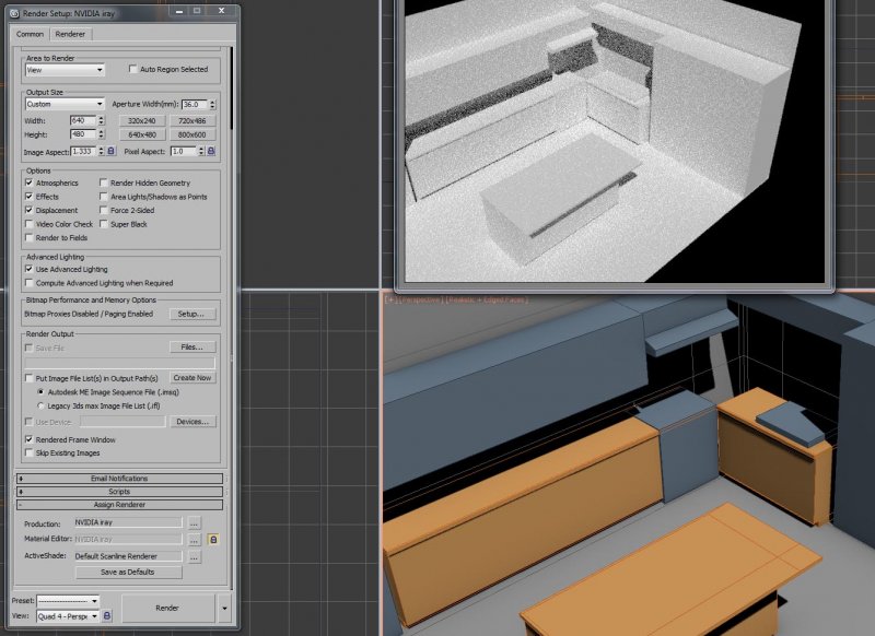

Hello guys,
I am having issues with the iray renderer. When rendering it comes out gray, rather then the colours that are in the scene. Also I tried different materials the Autodesk with different colours but they all come out as black and white. I've seen videos on youtube where iray is used as active shade, and it is now available in 2013 version, I want to use it, but it is no use if I have all the colours and materials, but the render is monochromatic.
I hope some of you use iray regularly and can give me some tips on how to resolve this issue.
thank you,
I found the problem, I didn't apply A&D materials in result everything rendered grey. Thank you
