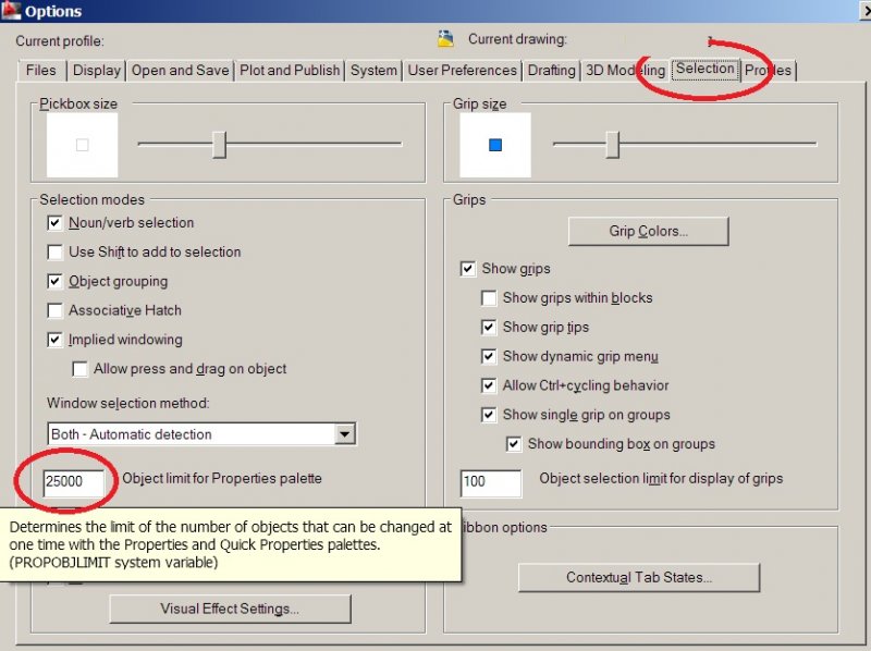

nicbazwilly Posted May 22, 2012 Posted May 22, 2012 Morning all, hope we are well. After much searching i finally feel the need to post a question to you, it's really hurting my head. Something so simple as highlighting all layers in a section and changing onto a different layer! When i do this not all the layers change. Explode explode explode.... Change layer! No success. I must be doing something wrong. I have to currently select in small sections to change layer and colour etc. It seems when i select too much it won't allow me to change the layers. Thanks in advance AC2010 Quote

nestly Posted May 22, 2012 Posted May 22, 2012 Do you have anything that looks like this in your Options? Quote
nicbazwilly Posted May 22, 2012 Author Posted May 22, 2012 Yes i have changed this to the max 32K but the problem still persists? It was originally set at 100. Quote
nestly Posted May 22, 2012 Posted May 22, 2012 You're currently using 2010, not 2008 as it says in your profile? If you're trying to change the layer from the Ribbon, I seem to recall an issue similar to what you've described. Try making the same change from the Properties palette, and/or the Layers toolbar.... if that works, then you blame the new Ribbon Layer Control Quote
nicbazwilly Posted May 22, 2012 Author Posted May 22, 2012 Yes 2010. I have just updated my profile. Thanks Ahhh the penny drops. Yes that works. Still frustrating having to change what you know and are used to!! Wonder what the problem is then? Quote
nestly Posted May 22, 2012 Posted May 22, 2012 The "Problem" is that the Ribbon is a huge resource hog. The default is only 2500 obects.... just don't make it too high or you may see a performance hit... RIBBONCONTEXTSELLIM Quote
