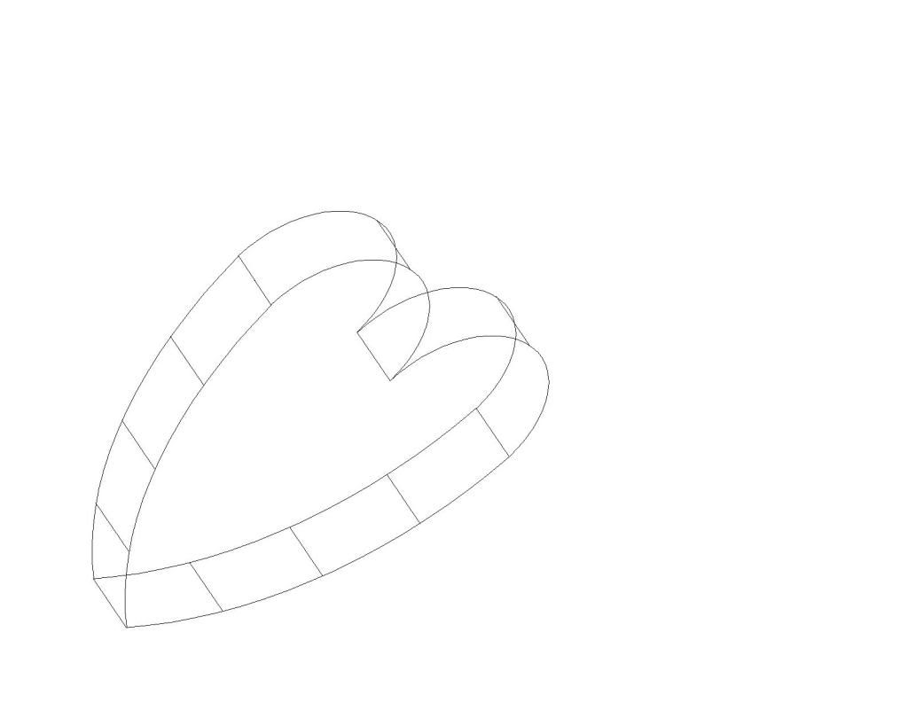

here are a few ways you can do it. You can draw your heart 2d. make it a region or use pedit to close the polyline. extrude this your height of .75. then fillet the edge with radius .75.

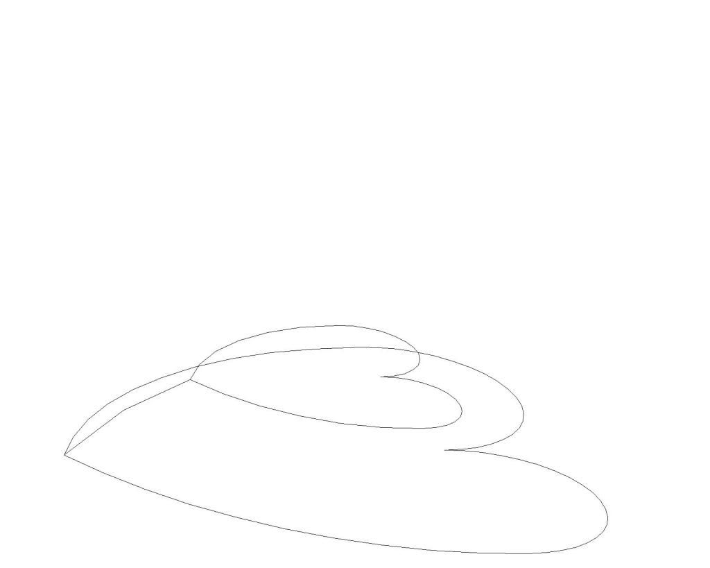

You could draw the heart, then draw a profile of your edge and loft it or extrude path. if you make the profile correctly and your heart is within a certain proportion you can get away with this without filling the center in.
you can draw a 2d heart at z-0 plane. then draw a smaller one or copy then scale your heart down at a different z height. create a path you want your loft to follow(arc) and use loft. It really depends on what you need the final piece to look like.
im using 05 so i cant show you loft or sweep(introduced in 07s toolbars) but here are a few quick drawings. this one is what your solid would look like before you fillet. You may need to address the sharp corner because doing a fillet may not work for you there. It filleted 1/2 of it fine for me but it really didnt like that transition, 09 may be better about it.
http://i268.photobucket.com/albums/jj39/shift1313/cad/Drawing1-Model.jpg
this drawing is what you would use for your loft. the two hearts will be your first and second cross section. then the single arc would be one guide(you will need more). or you can draw several heart cross sections and use them as multiple sections for your loft.
http://i268.photobucket.com/albums/jj39/shift1313/cad/Drawing1-Model2.jpg

Here a sort of step by step. I actually just made cross sections of the shape, scaled them, set them on different elevations and then LOFT the cross sections. for the last section for the sort of apex i place a very small circle as the last section to sort of close the convex.
You could also try the draft angles option if you want to toggle how the shapes will fit with each other.

Awesome, I think i got it guys. Thanks for all of your help.
