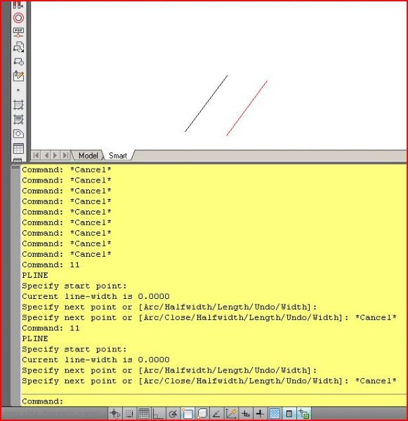

And if you are not using an extended right click, but merely selecting CANCEL from the right click menu? The red line was ended with the cancel from the right click menu. The black line was created first and using the ESC command after. :beer:
