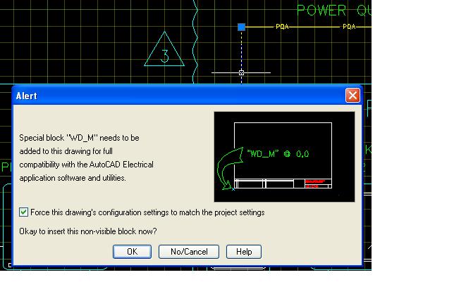

dbroada Posted May 24, 2012 Posted May 24, 2012 until today I had never used this method to "release" selected items, but if I do and I (even in another drawing) select a custom linetype a right click doesn't release the object, it calls up the dialogue box shown below. and when I select "cancel" the line moves from where it was to the point on the cancel dialogue box. So while this feature may not yet have affected you, there is still a chance it will. Quote

nestly Posted May 24, 2012 Posted May 24, 2012 Good find there dbroada. There seem to be 3 groups of users 1) Those who don't know about DROPGEOM but aren't affected by it because their mouse/pick habits don't inadvertently activate it. 2) Those who don't know about DROPGEOM and occasionally incur unintentional moves because the accidentally activate it. 3) Those who know about DROPGEOM, and know how to avoid the pitfalls, but also reap the benefits. It was apparently added to AutoCAD in 2005, seems like there should be a variable to disable it (other than disabling PICKFIRST) Quote
