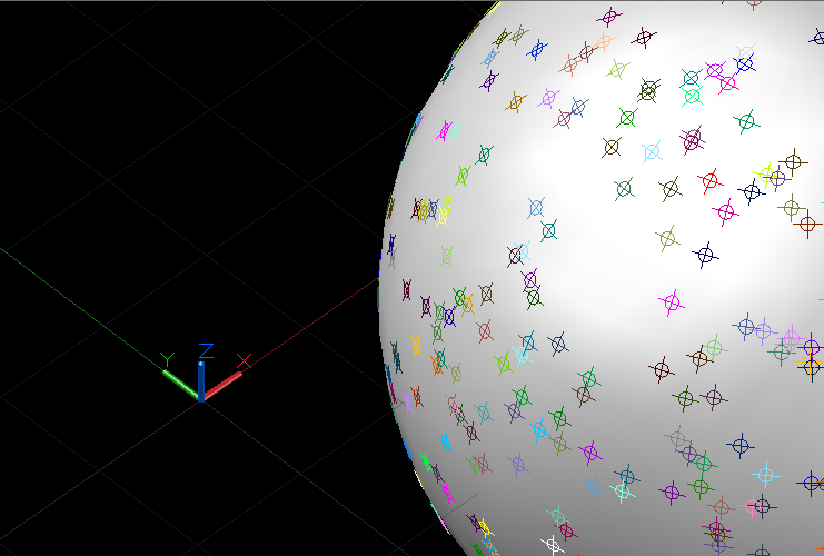

This is what i found with google, and i added random colours for points - and it doesn't work... help! What's wrong?

It works on my stations - the points are equally distanced from selected center, so they lay on a sphere; also the colors seems to follow a quite random pattern.
What I suspect is that the color issue is related to the speed of your workstation; to rely on computer's clock to get random numbers on a powerful station isn't very reliable since then you will not got truly random numbers - please check the example below:
(repeat 10 (princ (strcat "\n" (rtos (rangd) 2 5))))
You may check on Forum for a better random generator (it was a similar thread not long ago) or can add a delay between point generations.
this is what i get : Invalid color number.
; error: Function cancelled
strange...
Please try with ...10000 points
perhaps change the pdmode to 3 so you can see the points brams :)
Is working a little... for few times i succeed to put 5000 points...then error
Maybe add a protection to don't get unsupported color indexes?
[color=red](setq col 0)[/color]
[color=red](while[/color] [color=red](or (= col 0) (> col 256))[/color] (setq col (abs (fix (* 256 (rangd)))))[color=red])[/color]

Now is working, Pbe. Why not before, with (rangd) ?
as noted by MSasu if varaible color value is not within the valid range of 1-255 (ACI) it will not recognize that value and the command color will generate an error
(rangd) has value between 0 and 1,then i multiply with 256, i use abs. and fix - how can be out of range 1- 256?
How can i make a cube instead of sphere? :)
for example when its "0" , try assigning color 0
(command "_color" 0)
BTW: where dd you get theat cool routine?
EDIT: i did not really test rangd value if it ever exceeds 255 after evaluation .. but the snippet we posted will prevent that anyway.
Edited by pBe
Since may generate a 0 value.
