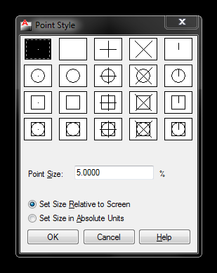

client wants me to change these is there a list so I can change them back to how i want to see them after i ship out the drawing?
Thanks
Are you looking for something like this? Got it by using the DDPTYPE command.
In our civil dgws we often use points to see a field surveyed point rather than a created one use about 100-200mm or say 4-6" rather than percent just gives a nicer visual then you can toggle them off and on by using like Remark DDptype.
