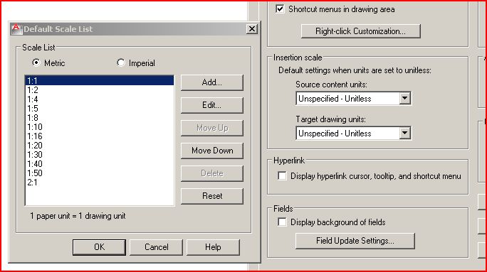

Dadgad Posted May 28, 2012 Posted May 28, 2012 Hi All! I have an ongoing discussion with my collegue about what setting is the best for INSUNITS. We always have a lot of blocks and x-refs so we run into problems with this often. I am of the opinion that since you can never be sure that the files you get are set at the correct INSUNITS or set to any INSUNITS, it's better to have your main file set to UNITLESS. My collegue (who is also my boss but lets not hold that against her) is of the opinion that since we draw in meters we should have INSUNITS set to meter and then the files that are correct INSUNITS set will work, and you'll have to deal with the rest. What is your opinion? How do you handle files with INUNITS-uncertainty? And lets refrain from the Everyone should just learn how to use AutoCAD and set INSUNITS correctly-argument. I can wish it as much as I like, it won't change the majority of the files I am getting. Personally I always use UNITLESS, whether creating blocks or setting INSUNITS. I work in METRIC, but in my USER PREFERENCES set the insertion and target units to unitless, as shown in the image. Quote
