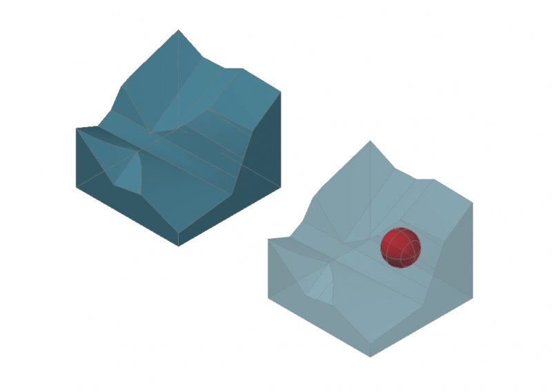

Both 3D solids are the same. Both encompass a red sphere. The transparency setting for the object on the left is "1" while the transparency setting for the object on the right is "60". The higher the number the more transparent the object.
