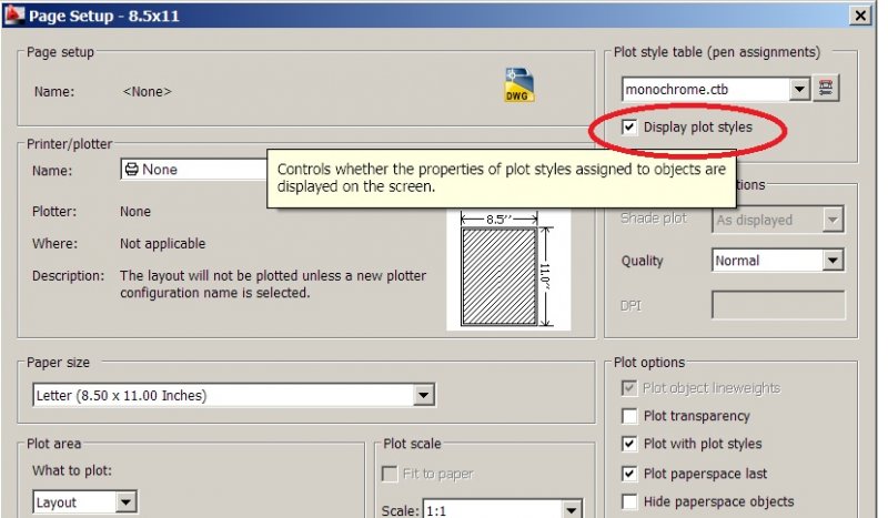

I don't believe you can change the display of something with a property override except perhaps by using a plot style (STB?), which you can then apply to a Layout in the Page Setup Manager.

I just verified that plot styles can definitely over-ride property over-rides (native and xref'd objects)
