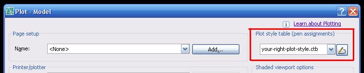

Blackfish Posted June 3, 2012 Posted June 3, 2012 You should have the same plot style for PDF as you use for the 'right' plot i.e. 'your-right-plot-style.ctb'... Sorry for that, but acad.ctb was in my image by accident, it's showing where it is in dialog box. Quote

Blackfish Posted June 3, 2012 Posted June 3, 2012 Which one you used and you said it was OK... that one for 'DWG file'? And for more info about how to create your own plot style look at that tutorial: http://www.ellenfinkelstein.com/acadblog/tutorial-create-a-plot-style-color-dependent/ Quote

Grant Posted June 6, 2012 Posted June 6, 2012 If you use the Acad Std CTB file it does not know what pen assignments you have done. You will need to make your own CTB file and assign the pen thicknesses to say a colour You also could try Monochrome - but that will still only do 1 thickness pen type. Quote
Dana W Posted June 6, 2012 Posted June 6, 2012 If you use the Acad Std CTB file it does not know what pen assignments you have done. You will need to make your own CTB file and assign the pen thicknesses to say a colour You also could try Monochrome - but that will still only do 1 thickness pen type. I use monochrome.ctb exclusively and it plots lineweights perfectly for me, even in pdf. But then, I have not monkeyed up my pen assignments. What I don't do is use CutePDF at all. I use AutoDesk TrueView (free) to plot my pdfs. I started using it when I discovered that AutoCad 2009 has bad issues with its own dwg to pdf.pc3. TrueView simply uses all the drawing and layout specs already set up in AutoCad. All you have to do is 'open with' and plot. Original OP, are you selecting "Plotting with Plotstyles" on the layout? Do not select the "Scale Lineweights" option. Quote

Grant Posted June 6, 2012 Posted June 6, 2012 What you can do is edit the CTB file - usually I make a copy of it and change the copy because if it is in the same directory it will come up in the list as well. Dir: C:\Users\'Youname'\AppData\Roaming\Autodesk\AutoCAD 2013 - English\R19.0\enu\Plotters\Plot Styles of course mine is Acad2013 but it should be similar. Then In Acad: Plot In 'Plot Style Table' click the CTB file you want to change Click the button on the right of that, that edits the file Goto Form View tab Click Color 1 (or any one) Change the lineweight thickness Quote
