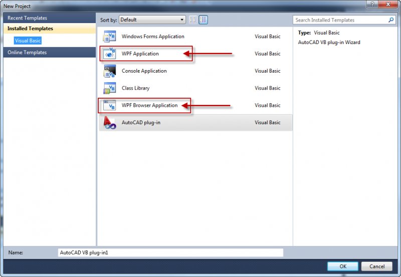

Bill, I have a friend that I'd like you to meet... Windows Presentation Foundation (WPF), meet Bill.
Sounds like the two of you are meant to work with one another, you both want creating an intuitive user interface to be simpler, faster, and allow the code behind (the meat of the app) to perform to it's full potential.
In short, WPF uses Extensible Application Markup Language (XAML, a derivative of XML) to separate the interface from the code behind, effectively making applications better looking, and performing at the same time.

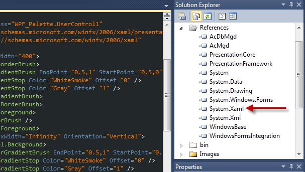

Note - I would not suggest using WPF applications (within AutoCAD) unless compiling to .NET 4 (or higher), as 3.5 requires that System.Xaml be removed as a reference (effectively limiting features, etc.).

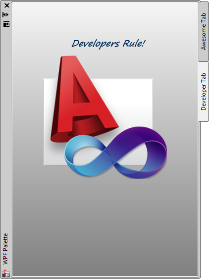

In addition to Hosting WPF User Control Inside an AutoCAD Tool Palette, I am also a fan of WPF Browser Applications for the simplicity, and ease of maintaining the application across my region's offices... I mainly use the WPF Browser Application as a 'reference utility' for quick access to design criteria, forms, documentation, etc. for users.
