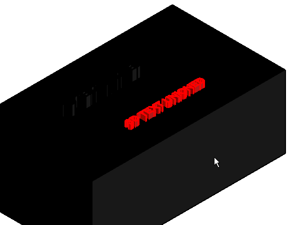

User2012 Posted June 14, 2012 Posted June 14, 2012 I want to make a UNION of a 3D object and 3D Text, but Union Command doesn't work! Any suggestions! PS- Attachment includes dwg file 3DText.dwg Quote
nestly Posted June 14, 2012 Posted June 14, 2012 You can't union blocks, but I have no idea what you did to make those letters unexplodeable anonymous blocks. *edit* non-uniform scaling is why the individual letters could not be exploded. Quote
User2012 Posted June 14, 2012 Author Posted June 14, 2012 Thanx fr your reply! The 3D text created is not block. I made it through AppLoad>3DText I could easily explode it though! (See attachment), but once again exploded text can't get unioned with the box! 3DText.dwg Quote
nestly Posted June 14, 2012 Posted June 14, 2012 (edited) Yes, the word "3D TEXT UNIONED" is a block. Inside that block, each letter is it's own block. Inside each letter is a solid, and a solid hatch. Each of the letter blocks is scaled non-uniformly, and therefore can not be exploded until the XY and Z scaling is normalized. Edited June 14, 2012 by nestly Quote

User2012 Posted June 14, 2012 Author Posted June 14, 2012 I see your point. But I didn't add them as a block. As I said earlier, I used AppLoad> 3d Text The text created would behave as a block though! If you have some other ideas to create the 3D text in CAD,plz let me know. The goal is to make a unioned feature from Quote
nestly Posted June 14, 2012 Posted June 14, 2012 The 3D Text lisp made it into block(s), that's how it works (see above) You can still use what the lisp created for a Union operation, you just have to exploded it down into Solids again. The entire procedure is shown below (watch in full screen for best results) Quote

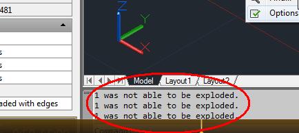

User2012 Posted June 15, 2012 Author Posted June 15, 2012 Thanks a lot for the screenshot. I followed your steps and it worked well! But I don't know why I couldn't make it for another example! The only difference was the height of 3D Text. I most likely missed sth! plz take a look at the screenshot http://www.screencast.com/users/CAD_USER2012/folders/Default/media/bcecff18-da32-4b97-b9ad-f8966d99c2c6 PS- dwg file enclosed. 3DText_Height0.05.dwg Quote
nestly Posted June 15, 2012 Posted June 15, 2012 The 2nd explode operation partially failed because all the letter blocks were scaled X=0.2 Y=0.2 Z=0.04. The X,Y, and Z scaling must be equal before exploding a block containing 3D objects. The hatches separated from the block, but each of "letters" remained a block. Quote
