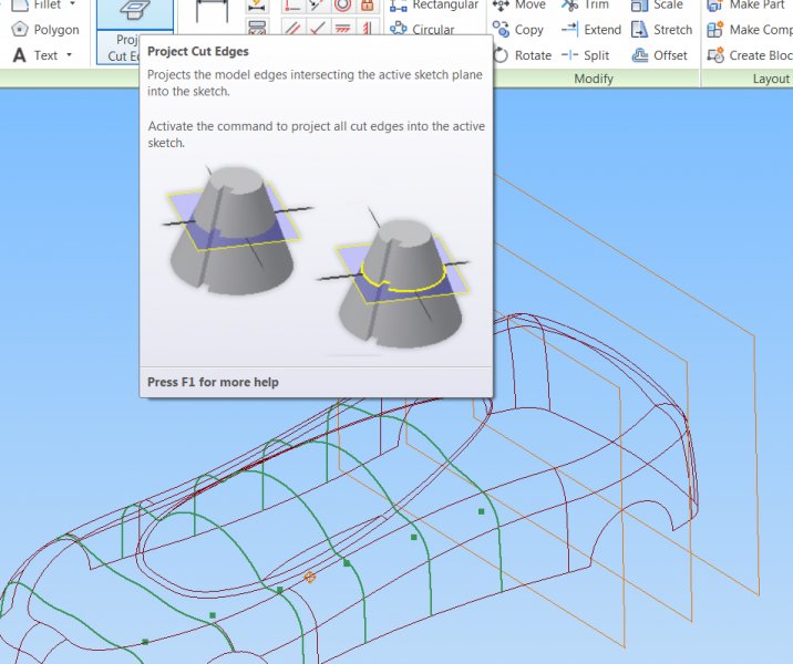

Sounds like you need to create workplanes, start a 2D sketch on workplane and Project Cut Edges.

Thanks for the speedy reply. I am not trying to project edges into a sketch. In the .jpg you posted, there is a set of planes that slice the model up. What I need is a way to take a slice of the model between two planes, and get rid of all of the surfaces on either side of them. I want to be left with surfaces, but only the ones between two of the planes. I will use these surfaces for milling purposes. The CAM program I am using (BobCAD) does not have any way that I know of to ignore parts of a model, so I have to modify the model before I import it to show only the slice of the whole model that I need.

Use the planes that JD laid out, then use either the SPLIT or TRIM tools.

To tag-on to Bishop. Create the work planes whatever distance appart you want then. After you split the solid into seperate solids. Use the Manage tab and the Make Part button to create individual parts for export to your CAM Program
