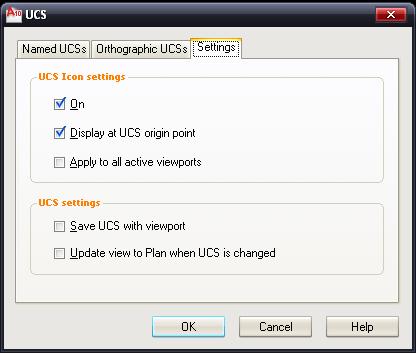

What do your UCSMAN settings say for each viewport?
I dont want to mislead you or tell you how to operate, but from my personal experience (3D modelling), it has always been best to have a consistent UCS in all your viewports (in MODEL space).
You might find that you have a setting enabled which will allow you to save/set the UCS independently for each viewport. Meaning that if you change your UCS in 1 viewport... it will not affect your UCS in any other viewports.
Let me know what your settings are (run UCSMAN command in each viewport) and you might need to make some adjustments.
My UCS settings are as follows...

@Iamsterms: Thanks for the help... I DO have the "Save UCS with viewport" checked; I will uncheck and see if this helps. All other settings the same. Thank you much!
No worries mate, just keep in mind that these settings are viewport specific. So any changes you make, you might need to make for each viewport.
