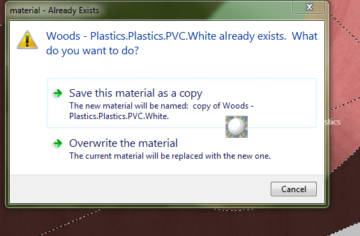

jbctln Posted June 19, 2012 Posted June 19, 2012 Hi guys, this is my first post here.. hope someone could help me... i have a problem applying materials/ color on a single face of a 3d object. I have read about holding "ctrl" frst.. what's annoying is this message [see attachment below].. what causes that prompt? How can I get rid of that..? I try to click "overwrite" but it applies the material on whole 3d.. what should I do? thanks! Quote
lamensterms Posted June 20, 2012 Posted June 20, 2012 Hi mate, Im not too familiar with AutoCADs material/rendering capabilities (I use an external program for all my rendering). Taking a guess, I would say that "Duplicate messgae" your getting has little to do with what you're trying to do, and more with how you're trying to do it. Try this... 1. Type PROPERTIES at the command line to bring up the properties dialogue box. 2. In the top right corner of the properties dialogue box there should be a button - "Select Objects"... click that. 3. While holding CTRL, pick the faces you wish to modify. 4. Select desired material from pulldown in properties dialogue box. Note... in order to use CTRL-pick to select individual faces, you might need to disable history for that particular solid; this can be done in the properties dialogue box. Good luck. Quote

JD Mather Posted June 20, 2012 Posted June 20, 2012 (edited) ..... No need to go around and assign the material to individual objects. I must have missed something in the original problem description (it sounds like you are describing a different problem in your current work). i have a problem applying materials/ color on a single face of a 3d object Materials.dwg I saved this back from 2013 to 2010 - so not sure the "materials" (I prefer texture as the proper term, as there are no material properties associated with the AutoCAD cosmetic texture) will transfer going back. Ctrl select the face, right click on the "material" and select Assign to selected. Somehow I think there is also a method of getting a "paint brush", but I have not discovered a reliable way of getting there. Perhaps someone familiar with AutoCAD will come along and explain how it's done. Edited June 20, 2012 by JD Mather Quote
lamensterms Posted June 20, 2012 Posted June 20, 2012 To get the paintbrush to apply materials - im pretty sure you just double click the material thumbnail ("Available Materials in Drawing"). This method will work with CTRL+Select. FACE MATERIALS.dwg Cheers. Quote
jbctln Posted June 21, 2012 Author Posted June 21, 2012 Hello, that CTRL + Select works for me for once. Let's say for example I have a cube which I want to apply 6 different materials on 6 different sides/faces. LEt's say I'll put material1 to face1 using this step (Pick material, Drag to face while holding CTRL) , it works there. Same when applying material2 to face2. But when it comes to the face3, the material apllies to the whole object.. What will I do? Btw, im using autocad 2010. Quote

lamensterms Posted June 21, 2012 Posted June 21, 2012 Hello, that CTRL + Select works for me for once. Let's say for example I have a cube which I want to apply 6 different materials on 6 different sides/faces. LEt's say I'll put material1 to face1 using this step (Pick material, Drag to face while holding CTRL) , it works there. Same when applying material2 to face2. But when it comes to the face3, the material apllies to the whole object.. What will I do? Btw, im using autocad 2010. Sometimes when using CTRL-pick to select individual faces, you might need to disable history for that particular solid; this can be done in the properties dialogue box. Thats what I find in 2010. Does that help? Quote
JD Mather Posted June 22, 2012 Posted June 22, 2012 I don't recall how 2010 works, but in 2013 I am not using the Ctrl Drag method. In 2013 I am Cltr selecting the face and then right clicking on the material and selecting Apply to Selected. Quote
