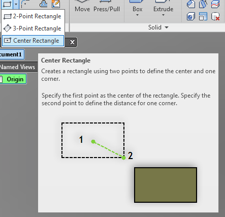

JD Mather Posted June 21, 2012 Posted June 21, 2012 (edited) Or you could download FREE Inventor Fusion which has a CenterPoint Rectangle tool. http://labs.autodesk.com Edited June 21, 2012 by JD Mather Quote
