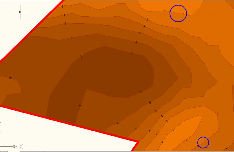

I create a surface and want to add contour labels, but labels must be oriented from lowest point to the highest. But it is oriented different in different places. Generally from highest to lowest point, but not always. prscreen1.jpg

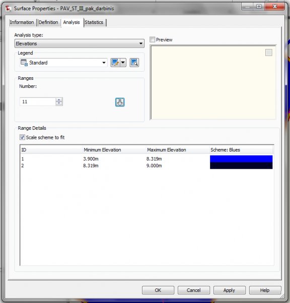

I remembered one more problem in surface. In "Surface Properties" window "Analysis" tab. I add "Ranges Number:" 11, but it will add only 2 ranges. It is common problem.

In answer to your orientation question...C3D is orienting in a "readable" and parallel to the contour line. You may change the orientation to whatever you want in the style settings. I am not familiar with an orientation from lowest to highest...generally I see contour labels online and parallel to the line being identified.

Lastly, it looks like you need to click on the apply or is it the arrow pointing downward to send the new number of ranges to the panel below?

I found a solution for a first problem. In "Label Style Composer" -> Behavior -> "Orientation Reference" must be Object. And in Plan Readability -> "Plan Readable" must be false (this was true in default and here was problem).

And for third. I press arrow (it is marked in picture). If I write number 15 and press arrow only 2 ranges will be added, but if I write 8 only 1 range will be added.
