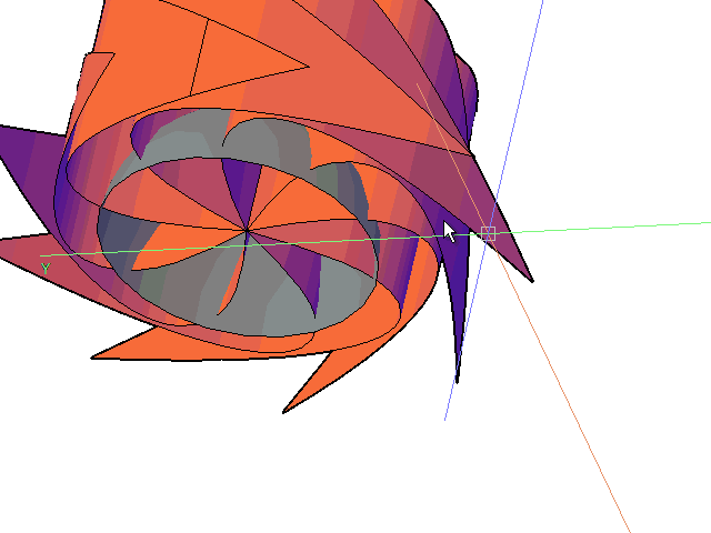

Hi everyone,
I'm working on this model and I am trying to use the surftrim command in cad 2011, but its not working and its pissing me off. I want to use the trim and use the dome in my model as the cutting edge to cut the parts of the curved walls that fall inside the dome but it is not working. I would really appreciate any help. I have photos of the model, i couldnt upload the dwg.
Oh btw I dont know if it makes a difference or not but Im using CAD2011 for Mac.
Thanks
I dunno about SURFTRIM.... is it supposed to be able to trim Surfaces with Meshes? (because the "dome" is a Mesh)
SURFTRIM and SLICE both seem to work when the Objects and the Cutting objects are Surfaces.
