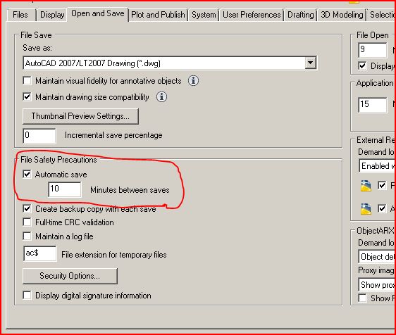

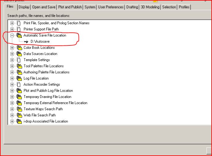

Dadgad Posted June 24, 2012 Posted June 24, 2012 Chect to see if your AUTOSAVE is turned on, and if so, the location of your AUTOSAVE file folder, as displayed in the two images. Quote

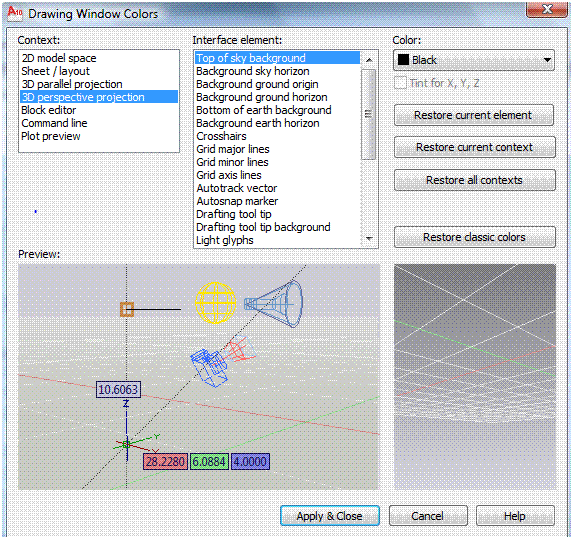

Marktuc Posted June 24, 2012 Author Posted June 24, 2012 here is the display settingsI tried selecting 2D model space but it defaults back to the 3D Quote

Marktuc Posted June 24, 2012 Author Posted June 24, 2012 Yes I do have autosave on and it is set for every 10 min like your pic Quote
Dadgad Posted June 24, 2012 Posted June 24, 2012 I don't see any need for you to be adjusting your drawing window color schemes right now. This is not the problem. Please read and follow my previous posts. Quote
Dadgad Posted June 24, 2012 Posted June 24, 2012 Do you know where the AUTOSAVE files are stored? If not go to OPTIONS, and on the FILE tab, as shown in post #5 you can check to see where they are stored. Go to the AUTOSAVE file, once you know where it is, and check for a .BAK file with the same drawing name as the one you are hoping to restore. Should you find it, right click on it and RENAME it. What you want to do is change the file extension to .dwg , then open it and see if your 3D modeling work is still in that file. Good luck, hope you get lucky. Quote

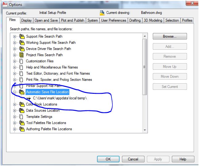

Marktuc Posted June 24, 2012 Author Posted June 24, 2012 Thanks for your help. I went to options and found the autosave but it says that it is in a temp file which I can not find. I've been saving the drawing on the desktop and it is labeled bathroom.bak. I open it through autocad. Quote

Dadgad Posted June 24, 2012 Posted June 24, 2012 Personally I like to specify another less transient location for my AUTOSAVE folder, although that is the default. Quote
